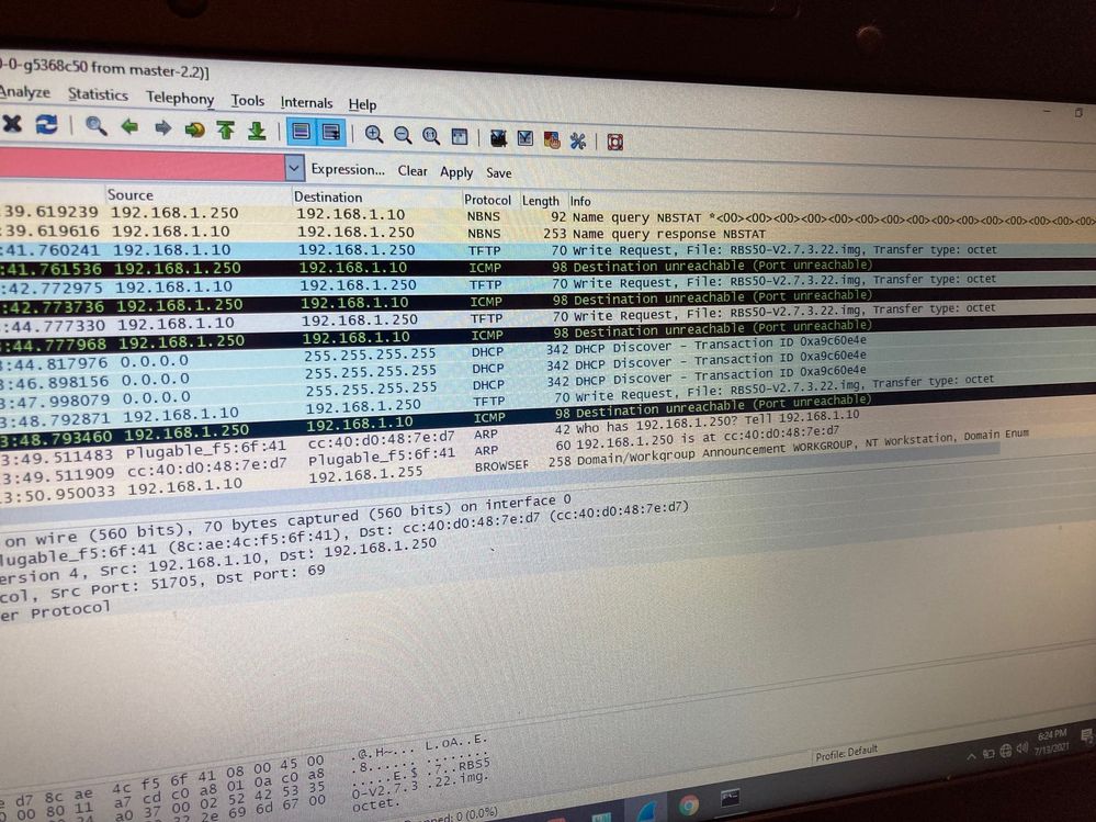

I enabled TFTP on my win 10 laptop. The attempt to transfer a file fails. I can only surmize that the device. is not listening on udp 69

RobU wrote:I enabled TFTP on my win 10 laptop. The attempt to transfer a file fails. I can only surmize that the device. is not listening on udp 69
My owb personal experience with tftp has been mixed.There seems to be a short window of opportunity after power is applied when the router listens for a tftp connection. Too early or too late and it doesn't happen. I seem to recall it taking 5 or 6 attempts to hit the sweet spot and make the firmware load.
- RobUJul 13, 2021Aspirant
Thanks again for your help. I made several attempts to both the Satellite and the router with no success. I dont think you could see the picture of my previous post. it was of a wireshark trace . my setup on the laptop /TFTP client and connectivity is sound. the netgear just doesnt allow for the TFTP connection. I have achieved what i really needed by buying a new Orbi mesh system with additional satellites. Unfortunately this was a costly solution. I still go back to my original point as to why or how Netgear would allow another vendor to put thier own code on a box. This pretty much locks you out. I wouldnt mind so much if i could have bought a satellite from Verizon or if Verizon just didnt up and decide that the dont support the orbi's any longer and dont provide a solution to anyone who purchased through them . Nor do they have people familiar with the fact that they did sell these devices and they did their own lousy engineering buy developing proprietery firmware. The RBS/RBR50 is a fine product. i just needed more coverage :( . I will wind up giving this system to someone in need.
