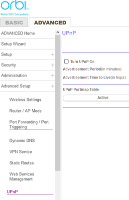

    2. Another Advanced Tab, Advanced Settings menu called UPnP can be enabled to allow devices on the LAN to open ports that point to themselves.  According to the Help Screen (arrow at the bottom of the screen), the default setting is enabled.  My guess is that the NAS has told the router, "let the internet connect to me."  Unchecking that box will remove this setting.
