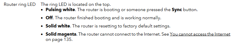

I have restarted and synched router and satellites. It is a mystery why the router is not showing blue. - CrimpOnAug 30, 2024Guru - Experienced User
The router on the original WiFi5 Orbi products never "turns blue". See page 9 of the User Manual:
https://www.downloads.netgear.com/files/GDC/RBK50/Orbi_UM_EN.pdf
Aside from the light, does the system appear to be working?
