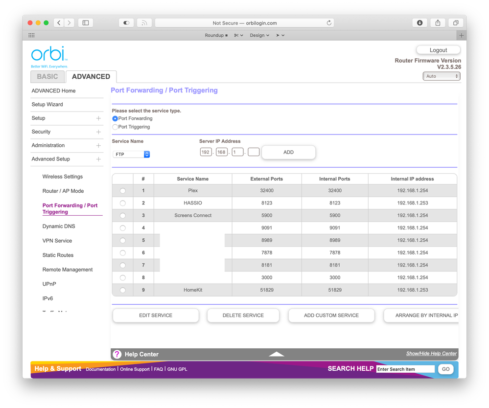

Do you have UPnP enabled in Orbi, or are you using port forwarding in Orbi?
If you use port forwarding, what port forwarding do you have configured now in Orbi?

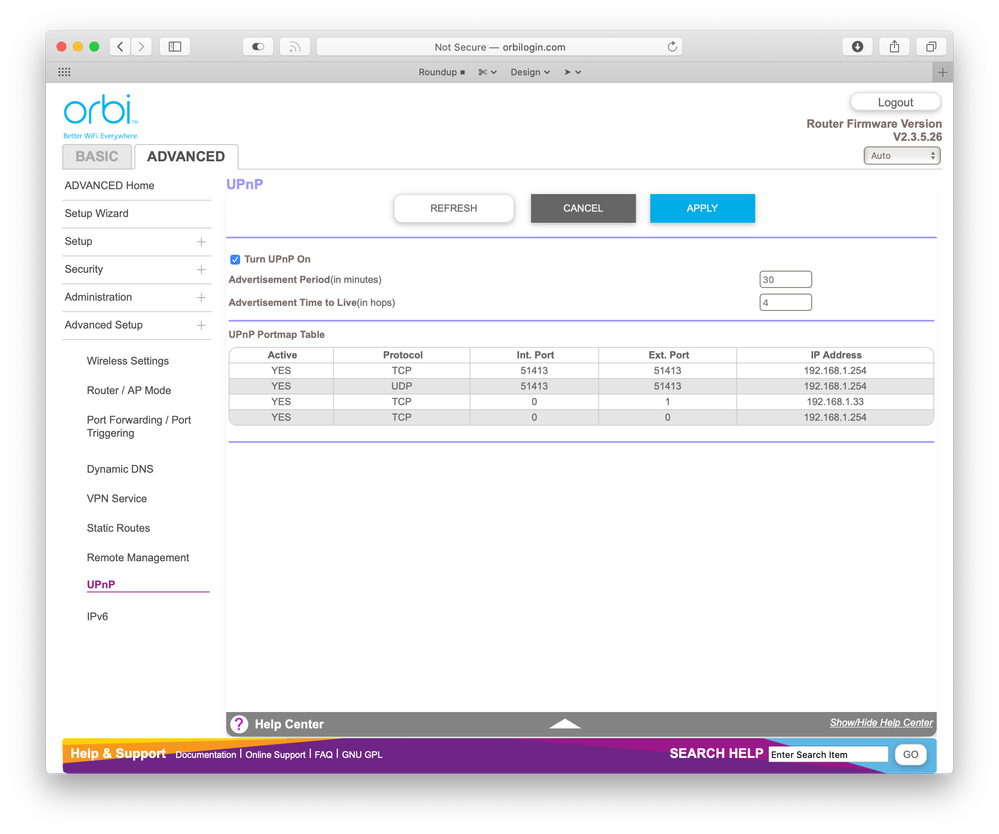

- chrisbrummelNov 03, 2019Guide
ekhalil UPnP is on, but it also looks like there's some port forwarding going on. Attached are 2 screenshots

If you have any PF configurations enabled, uPnP should be disabled...
chrisbrummel wrote:UPnP is on, but it also looks like there's some port forwarding going on. Attached are 2 screenshots
FURRYe38 I turned off uPnP, restarted Home Assistant, and started up the Home.app, but still get "No Response" from the Home Assistant devices in the Home.app. It doesn't seem to have changed anything.

- ekhalilNov 03, 2019MasterWhat port forwarding do you have configured? I can’t see the pictures that you posted until approved by a moderator. Can you please post them as attachments instead.
FURRYe38 — When you apply the change, the router restarts, but I didn't unplug it and plug it back in. The ISP modem is a Technicolor c2000t.
ekhalil — To the Pi, I am forwarding 8123 and 51829
Here's all that I'm forwarding:
- 192.168.1.253
- 8123
- 51829
- 192.168.1.254
- 32400
- 5900
- 9091
- 8989
- 7878
- 8181
- 3000
- 192.168.1.253

chrisbrummel Is the 51829 is the configured default port number in configuration.yaml in the Pi?
- 192.168.1.253
- chrisbrummelNov 09, 2019Guide
ekhalil Yes, it's 51829 in the config.

- Please try to change port 51829 to 51827 (tcp)
- You also need ports 8123 (tcp) and also 5353 (udp) for Home Assistant interface and mDNS respectively. I see that you have 8123 forwarded, but not 5353? Please try this.
- chrisbrummelNov 10, 2019Guide
ekhalil — On the Orbi, I changed it to 51827 (tcp), and opened up 5353(udp). On Home Assistant, I updated the config for HomeKit to call out "port: 51827". I made sure that the Home.app was "opening fresh" and checked out the devices — "No Response" :/
