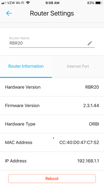

One RBR20, 3 RBS20's
Firmware 2.3.1.44 (all devices)

- FURRYe38Mar 29, 2019Guru - Experienced User
v44 should not be on your 20 series system i think. Unless you updated via AutoUpdate?
v28 is most current on the NG download site.
https://www.netgear.com/support/product/RBR20.aspx#download
You sure this is a 20 series Orbi system? Lets confirm model # please.
- sjaytMar 29, 2019Guide
I've only used the auto-update, never a manual firmware update. It's DEFINITELY and RBR20
