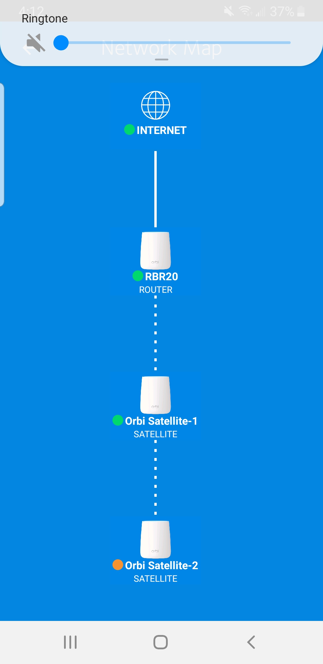

- CodybutsSep 06, 2019AspirantHey buddy, so nothing has kicked off..I ran orbi router + 1 satellite.
Orbi router front of house basement.
Satellite 1 back of house main level.
Everything been fine 300 ish Mbps sitting outside .
Satallite 2 plugged into garage, before even with 120 Mbps I'd get 30-40. Id expect atleast 100 as it's not far from satellite 1. Right now I'm getting 10-25 Mbps.
Satellite 2 is poor
Could you help me resolve this đ.
This is a pic of satellite 2.. right on other side of wall is satellite 1 .. if I'm close to wall I get 300+ Mbps.. inside garage no good. - CodybutsSep 06, 2019Aspirant
