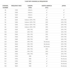

In Orbi, the DFS channels are only used in the wireless backhaul, that is the wireless interface between the router and the satellites.
To change channels when radar interference is detected is the correct thing to do and according to design. This change should be seemless and you should not see any impact. How do you notice the "wifi drops"? Do you see this on devices connected to both the router and satellites?

Try changing the wifi channels that you use for the 5 GHz as well as for the 2.4 GHz bands. It can be that you have disturbances from the surroundings?
- jandreuserveraJul 01, 2022Tutor
Wifi channels changed:
2.4GHz from 1 to 6
5GHz from 36 to 48
Let's wait several days to check if the wifi is stable. By the way, I see the connections between router and satelites are using 2.4GHz band:
Maybe it will make the configuration completely stable to 5GHz interferences, but at the cost of a lower performance. I would be happy with the stability even if i loose speed of transmission.
