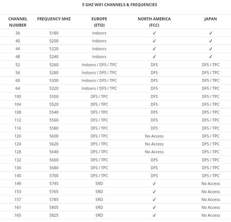

Wifi channels changed:
2.4GHz from 1 to 6
5GHz from 36 to 48
Let's wait several days to check if the wifi is stable. By the way, I see the connections between router and satelites are using 2.4GHz band:
Maybe it will make the configuration completely stable to 5GHz interferences, but at the cost of a lower performance. I would be happy with the stability even if i loose speed of transmission.
Thanks

As I see stability in the Wifi connection I think the change in Wifi channels has helped or maybe has not been any interferences in the surroundings.
I close the post.
Thanks
