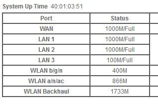

I'm trying to set one of the wired ports so that it is a separate VLAN for IOT (Smartthings hub).  How do i know which physical port is associated with Port 1 on the GUI?

    Using the web interface, bring up the Advanced Tab->Advanced Home, and click on Show Statistics.  This brings up a page showing the speed of each LAN port.  If (anything) is connected to only one of the ports and (nothing) to the other ports, only one port will show a connection.
