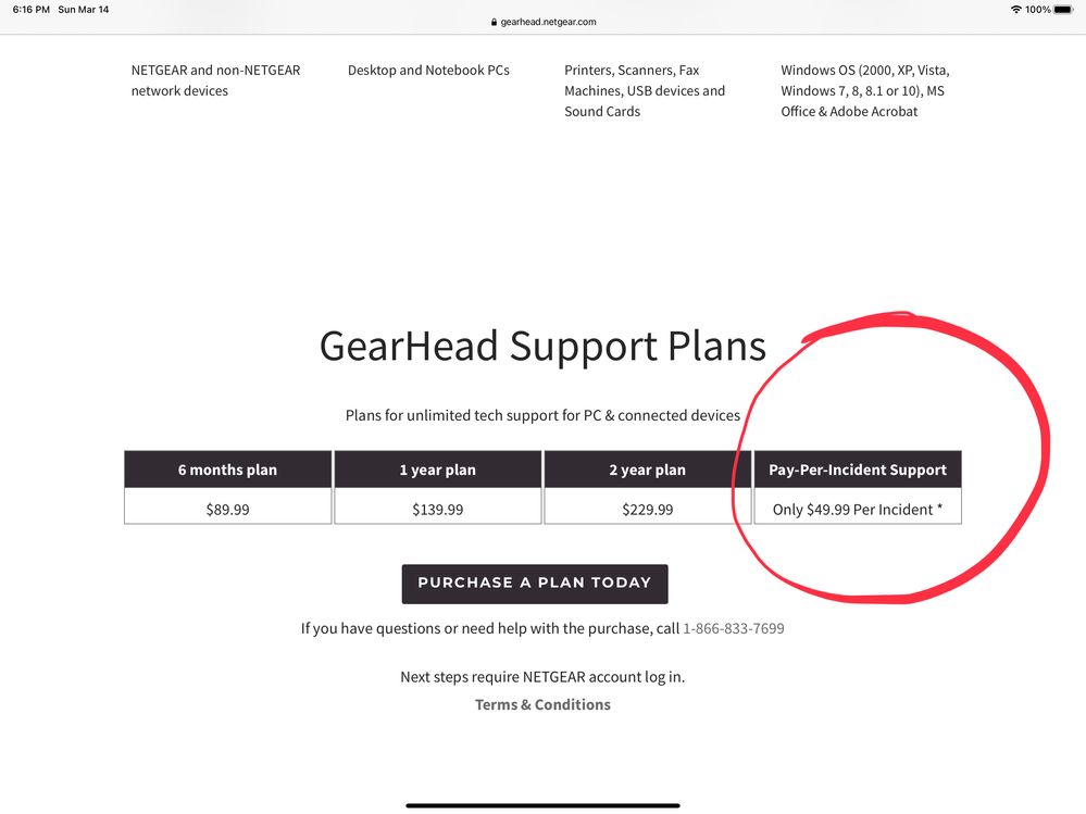

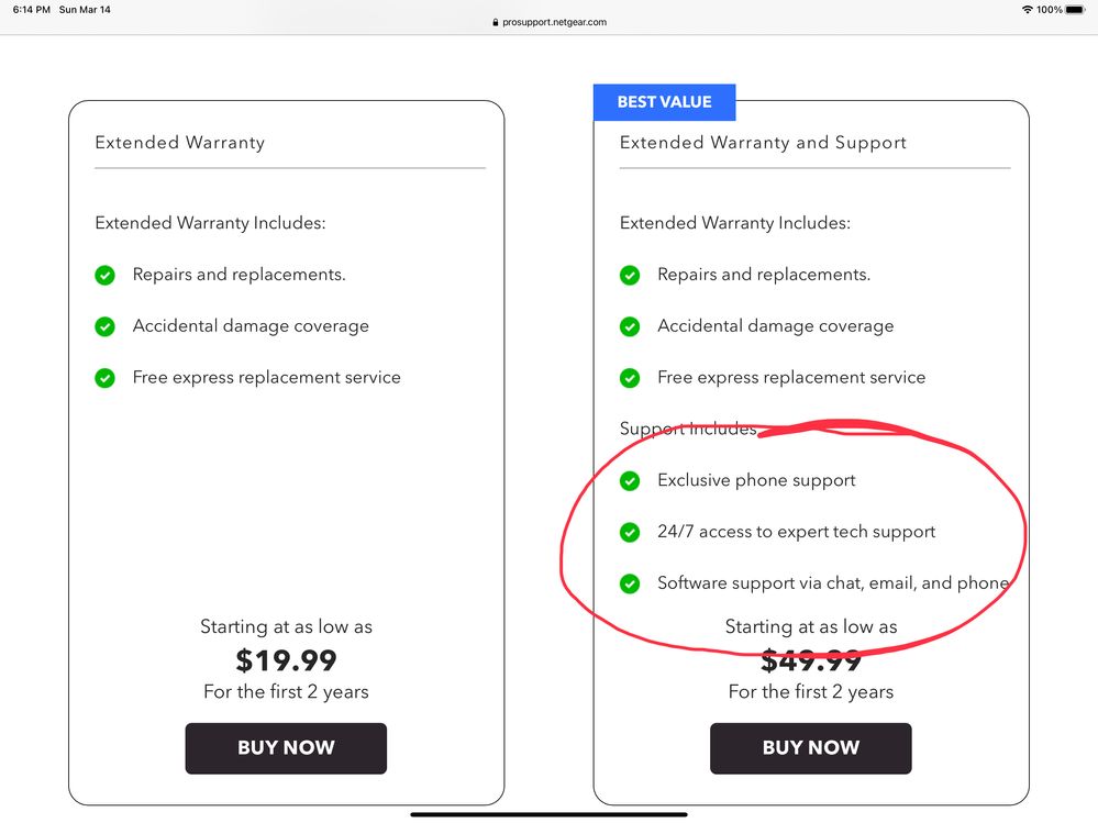

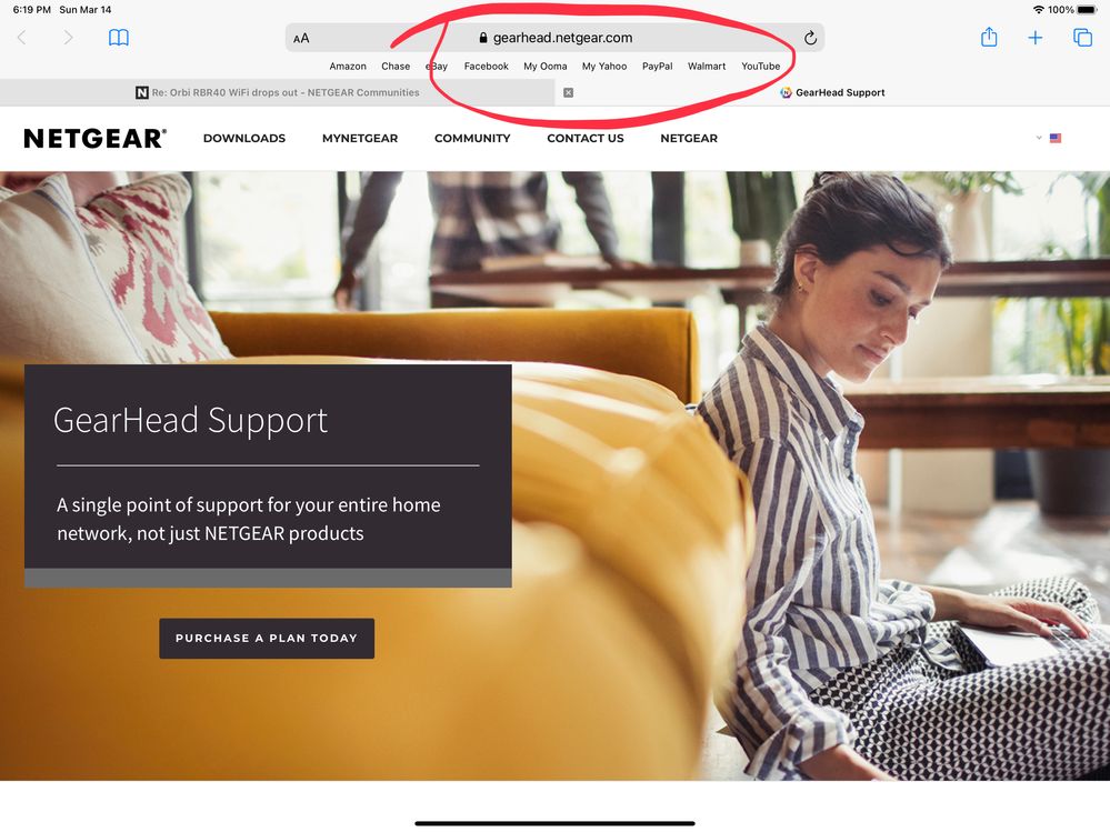

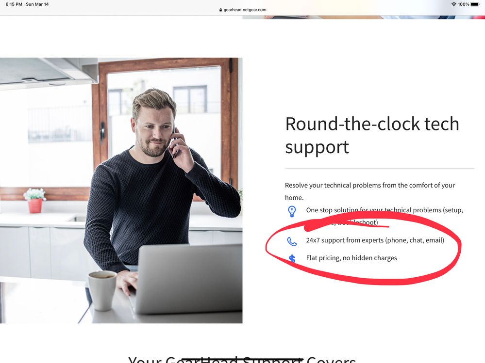

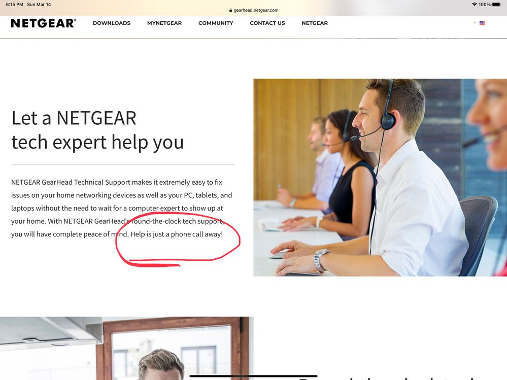

- dchbbcMar 14, 2021Apprentice
I have the same issue with my RBR40 and it only started a few weeks ago. I think after the power blinked on and off. I've done factory reset after reset and nothing fixes it. I have 3 RBS20 satellites and my wifi drops over and over. Wired works great. Some times on my ipad it will show full bars but I can't connect to the internet. Other times it drops all together. I'm getting rid of the system. I've tried to get help from Netgear online but they don't reply back and I'm not about to pay them $50 for a phone call.
- michaelkenwardMar 14, 2021Guru - Experienced User
If this was telephone number that you found with a web search IT WASN'T NETGEAR. There are too many scam sites out there that try to look like Netgear but in reality are dodgy operations that can damage your network and your bank balance.
There is no phone support for Netgear. You do it via the support portal:
Contact Us | Support | NETGEAR
First you have to register your device to confirm that it is eligible for the 90-days free support. Start here:
MyNETGEAR | Product Registration
Start a case and, with luck, they will contact you.
After 90 days, Netgear does not provide paid support. It farms that out to GearHead.
Or you can try to sort it out here. That costs you nothing.
michaelkenward It can be called Gearheads or Netgear, whatever make ya happy but it's offered by Netgear. The end result is the same. As far as getting answers here, I get more of what you did, making a comment instead of giving answers.
