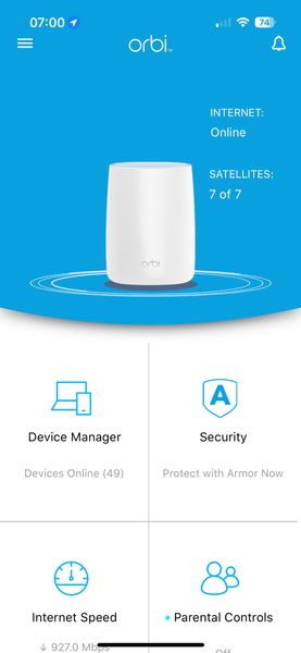

Orbi RBR50 / RBS50 network, not showing network map of connected devices
I recently picked up an RBR50 and a couple of RBS50s to extend my network and replace the RBR20 I was using as my router. In the process, I also updated the firmware of all devices to V2.7.5.4 T...

My guess is that information about the satellites is not appearing because they are in the "config sync" state. i.e. the router to satellite connection is not fully established.
My suggestion is to power them all off. One at a time, relocate each satellite to the same room as the router, do a Factory Reset (on the satellite), connect it to the router, and wait for it to sync. Then, relocate it back to the desired location.
Guess it would be worth asking.... Is the system actually "working correctly" in the sense that device have internet and are "happy" and the only problem is how they are described?

thanks for the reply - ill try that. (I also realised post is in the wrong forum section 🙄).
in answer to your question, 'working correctly' in my original context, basically meant that i can get an internet connection in every room, - I just dont know if it is optimised.

The "Unknown connection" shown is also a factor, probably related. All satellites are wired?
