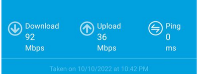

Hi all I'm a bit perplexed if I'm honest and would appreciate any help. As it says in the title I have an RBR50 and Virgin Media. I have been limited to 100MBPS package but just upgraded to ...

Oct 10, 2022Guru - Experienced User
What is the model# of the ISP modem the router is connected too? I believe most Virgin Media services have a modem with built in router. If so, This would be a double NAT (two router) condition which isn't recommended. https://kb.netgear.com/30186/What-is-Double-NAT
https://kb.netgear.com/30187/How-to-fix-issues-with-Double-NAT
Couple of options,
1. Configure the modem for transparent bridge or modem only mode. Then use the Orbi router in router mode. You'll need to contact the ISP for help and information in regards to the modem being bridged correctly.
2. If you can't bridge the modem, disable ALL wifi radios on the modem, configure the modems DMZ/ExposedHost or IP Pass-Through for the IP address the Orbi router gets from the modem. Then you can use the Orbi router in Router mode.
3. Or disable all wifi radios on the modem and connect the Orbi router to the modem, configure AP mode on the Orbi router. https://kb.netgear.com/31218/How-do-I-configure-my-Orbi-router-to-act-as-an-access-point and https://www.youtube.com/watch?v=H7LOcJ8GdDo&app=desktop
Try option #2 first...

- CrimpOnOct 10, 2022Guru - Experienced User
(I have spent the afternoon watching an Air Conditioning repairman run up a tremendous bill making my house cool again, and just now saw this conversation....)
One thing that stands out to me is that 92MB/s is a suspicious number:
i.e. it is about the maximum possible throughput over a 100MB Ethernet connection.
Could you please open the Orbi web browser interface (http://orbilogin.net), Navigate to the Advanced Tab, and click on the blue item in the Internet section titled "Show Statistics"?
What does the router report for the WAN Port? Is it:
- 1000/Full, or
- 100/Full
These days, Ethernet devices "auto-sense" the maximum speed that each is capable of and agree to use that speed.
https://en.wikipedia.org/wiki/Autonegotiation
The Orbi WAN port is clearly 1GB/s, and one might expect the Virgin port to be the same. (would have to see the Product Data sheet for the specific Virgin model to be sure). Sometimes there can be something "off" about the cable that causes the devices to negotiate a lower speed than expected.
(or..... I remain frustrated and confused by an unexpected repair bill and 92MB/s is merely a coincidence.)
