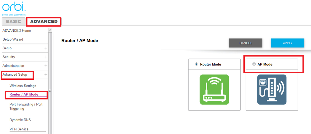

KerryBastow So this shows that you have double routers: the 10.0.0.1 is the Orbi and the 192.168.1.1 is the ISP router.
You need to keep only one of those routers.
As Chuck_M mentioned you have 2 options:
1. The easiest option for you is to keep the ISP router as the router and change Orbi to AP Mode. You can do this by logging in to Orbi (use browser to access 10.0.0.1 and enter admin as user and the password) then do the follow the links below:
2. The other option is to change in the ISP router as Chuck_M explained above.
The difference between the two options is which box you want the router functionality (DDNS, VPN, Parental COntrol,...) to be provided: by. Orbi or the ISP router.
