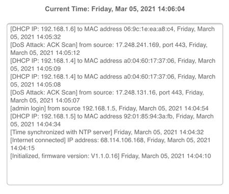

Orbi RBR50 and Spectrum - having strange issues.
To start here is the setup: Orbi -RBR50 w/1-sat. Updated to the latest Firmware Spectrum Device: E31N2V1 modem only updated to the latest Firmware (VOIP in modem but not used and the light does not...
