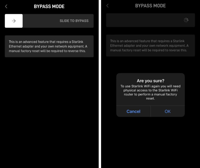

    What is the intention? You could operate Starlink with it's built-in (limited) NAT router, or connect the Orbi WAN (in router mode) to Starlink in Bypass Mode - almost like connecting a typical Cable Modem.

      I did connect in bypass mode.  I had wifi, but no connectivity to the internet.  I had this system running for several years using Viasat as my ISP, with Viasat in bridge mode.  Initially, I tried a shortcut by not bringing the Orbi router back to factory settings.  After that didn't work, I did so, but ended up with the same result.  So, I'm unsure if this older RBR50 isn't compatible or if there's an Orbi router setting that I need to alter.
