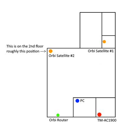

So this is a rough layout of where my PC is and where the routers and satellites are. It's not drawn to scale obviously, but it gives a general idea of where things are placed. I moved Orbi Satellite #1 directly next to my PC and connected to it via Ethernet and got the full 300 up and down. Disconnecting the ethernet and connecting to the Orbi Network gave me 280-300 up and down. So it's possible for me to get the full speeds on the Orbi Network, but I'd have to move the satellite into the same room which would make it a bit redundant since I should be getting the same speeds with the Orbi router in the next room over.
I can see on orbilogin.com and the Orbi app that my PC is connected to the Orbi Router with a link rate of ~300 Mbps on the 5GHz Connection Type with 2/3 bars of connection. I can also see that there are other devices connected to the Orbi router with a link rate of 650+Mbps with 5GHz connection type and 2/3 bars of connection.
Moving a Satellite to the same room as my PC solves the issue, but isn't an actual solution to my problem. Hopefully some of this information seems useful to any of you to see what else I can try or see.

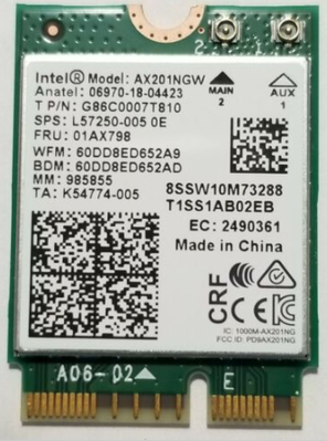

- CrimpOnOct 02, 2022Guru - Experienced User
ekhalil may be onto something with regard to the antennas. The Intel AX201 is an M.2 format, which indicates that it will be inserted into one of the motherboard M.2 sockets. i.e. a replaceable component rather than permanently soldered to the motherboard.
Notice the two antenna connectors at the top of the card. If you open the case, there should be tiny coax cables running from the external antenna location to those two connectors.

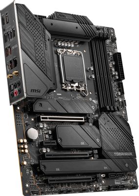

I'm not 100% sure where the M.2 WiFi adapter would end up being on the motherboard, but from where the antennas are situated on the motherboard I don't really want to take apart the shielding to see.
Thanks for humoring me about the antennas. That preinstalled shield certainly blocks access to everything underneath it. Would have been nice to verify that nothing "shook loose" in transit. Oh, well.
