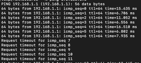

My RBR50 keeps dropping packets every minute or so. The glitching is killing my iphone and zoom calls. I've nailed it down to the router itself because I will ping the router address - 192.168.1.1 an...

Stronz wrote:My RBR50 keeps dropping packets every minute or so. The glitching is killing my iphone and zoom calls. I've nailed it down to the router itself because I will ping the router address - 192.168.1.1 and below is what I typically get. These drops happen completely arbitarily and are usually between 1 to 6 packets. I can't typically go more than a minute or two without a drop.
Here are all the things I have done that have not worked:
Changed from Auto Preamble to Short Preamble
Disabled Fast Roaming
Disabled IPV6
Disabled Daisy chaining
Changed 2.4g from Auto to channel 11
Changed 5g to 44Ghz from 48ghz
I changed modems from one manufacturer to another
Upgraded firmware to 2.7.3.22
I'm at my wit's end, help.
