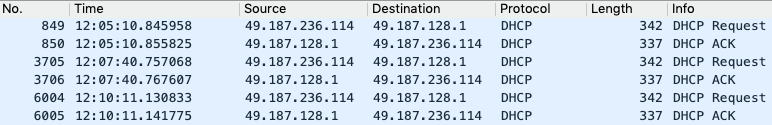

- joel_smithMay 06, 2021Tutor
Had some issues getting the log capture. Once I had captured a long enough period I can see the renewal packets.
- CrimpOnMay 06, 2021Guru - Experienced User
These are almost exactly 2:30 apart, which is what I would expect from a DHCP lease of 5:00.
If you use Wireshark to examine the DHCP packets, it will probably spell that out (in seconds).
Although what I consider "definitely absurd", I believe this is legitimate and may even be the default value. (Maybe these folks, "don't have a clue" and never changed the DHCP default?)
Alas, this does not explain internet service being interrupted. (Have I taken us off on a tangent?)
With logging working now, can you record traffic until there is an interruption and then dump the log when it resumes? (maybe while that ping trace is running?)

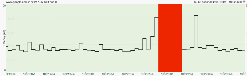

I captured the following drops ~10:22:18-10:22:24am.
I can see the DHCP Renewal Request & ACK slightly before the dropped connection at 10:21:59
I have captured the log files from the DHCP request through to the end of the dropped connection. I'm not really sure what to look for in these logs? And Netgear Community won't let me upload the file. As an alternative I have uploaded the log capture.
