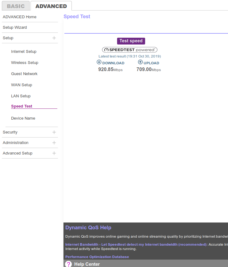

Oct 31, 2019Guide
I assume it is the QoS of the router because the speed tests always approach 50% of the speed detected by the RBR50 in its Speed Test (in router webUI > Advanced > Setup > Speed Test). I attach a screenshot.
Whether I test it from my computer connected by LAN cable to RBR50 or from my devices connected by wifi.
On the other hand a search for RBR50 + QoS on Google shows many results about this.
