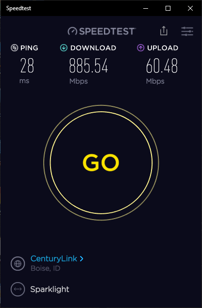

Ok, so I connected my RBR50 to WAN port #2 on my CM1100 cable modem. RBR50 is on WAN port #1. 1Gb/50Mbps
RBR50 is seeing near 900Mbps with my wired PC speed testing thru the RBR50 using Ooklas installable speed test app in windows 10: Orbi FW v40
Makes me wonder if type of modem or something in the RBRs detection of modems on the WAN side and such could be playing a roll in this. If I take the RBR50 and test it alone with just two PCs and a Gb switch, the RBR50 won't see anything much over 400Mbps. Seems like the RBR50's detection on the WAN side maybe a factor here.
So for this test, the RBR50 connected to a CM1100 cable modem is seeing near 900Mbps.

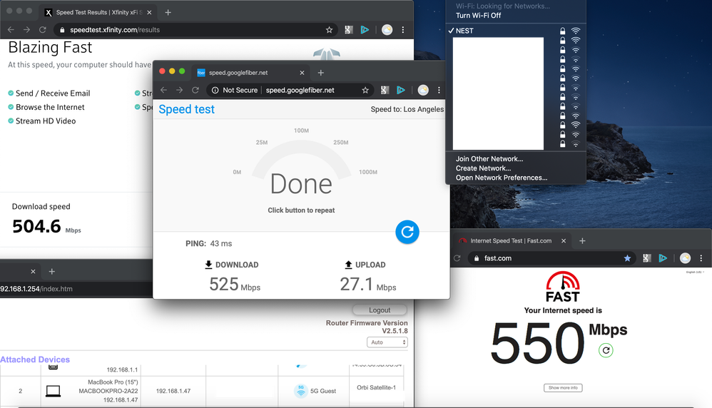

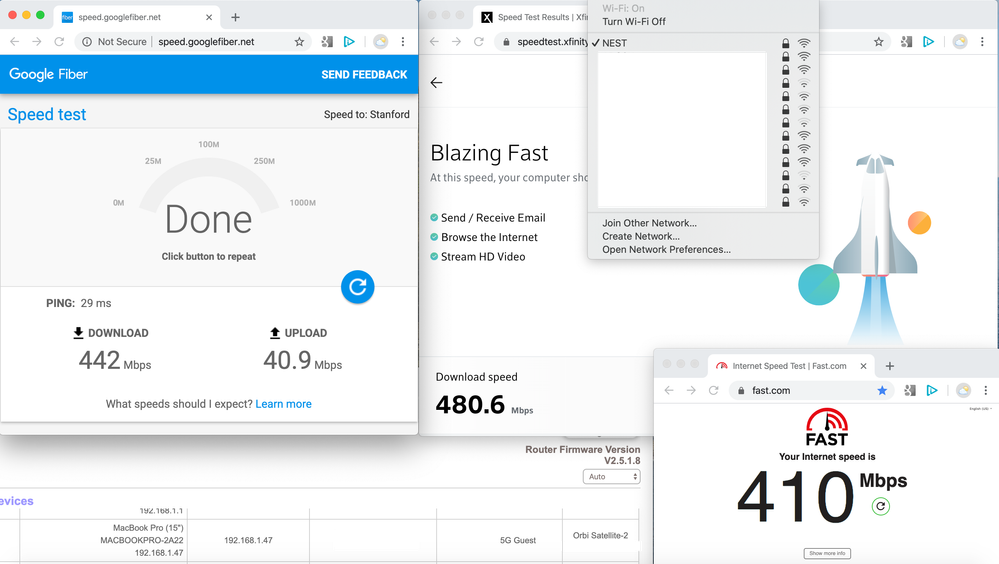

- SW_Jan 03, 2020Prodigy
With the latest firmware v2.5.1.8, Orbi is able to hit ~900Mbps in AP Mode or ~700Mbps in Router Mode.
Wireless backhaul is around 400Mbps-500Mbps:
