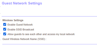

    Your expectation is correct.  Every device on the primary network (both wired and WiFi) should be able to communicate with every other device on the primary network.  (On the RBR50 product, there is a setting to control whether devices on the Guest WiFi network can communicate with the primary network.)

        Alas, the feature is part of the definition of the Guest WiFi network (only on the original RBR50/RBR20 systems):
        Orbi systems have no setting to specify which of the Orbi access points can be used.  Any device can connect to any access point (router or satellite) on any of the supported networks (wired, primary WiFi, Guest WiFi - IoT WiFi on some of the AX models).
        There appear to be two distinct reasons to have a Guest WiFi network:
        • To provide a method for transient users (i.e. "Guests") to access the network without sharing the primary network password.  Once they leave, the Guest WiFi password can be changed without affecting any permanent devices.
        • To provide a network for transient users that keeps them separate from the primary network.  i.e. they can access the internet but not communicate with devices on the primary network.
