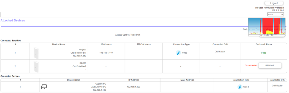

Looks like NG may have fixed the ARP storm issue with RBS Ethernet connected behind switches.
I see that the ARP Storm still happens however it seems to stop on it's own and settles in after about 2-3 minutes after the RBS is ethernet connected behind the LAN switch.
AP Mode:
Router mode:
I think NG could tune this a bit more to to get less ARP occurance. Though this is a start.
