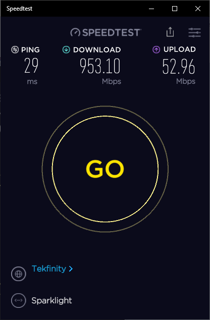

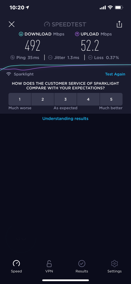

Speed test results with v102 loaded on a RBK50 System in AP mode. RBS ethernet connected behind two LAN switches.
Wired to RBR:
Iphone 12 Max connected to RBS:

- FURRYe38Dec 28, 2020Guru - Experienced User
Manually applied V2.7.1.60 then found v102 available to update to on the RBR and RBS.
About the same. I'll be trying router mode as well.

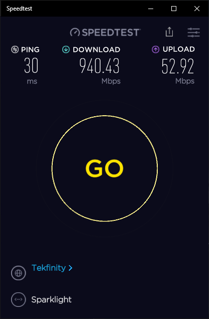

RBK50 online in router mode with v102 loaded behind a CM1200 cable modem:
RBS50 ethernet connected behind 3 NG GS series non managed switches. Small ARP storm seen when RBS was syncing then it stopped. Network is stable and working.

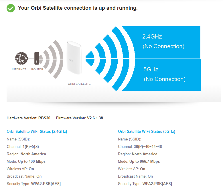

For users with a 50 series and a RBS20, be sure to upate the RBS20s FW. Mine connected via ethernet but the radios were disabled, so I updated the RBS FW since it was a few behind. Up and running now:
