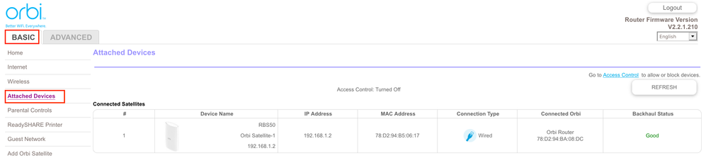

Do you see the Satellite anywhere in the “Attached Devices” list in the GUI?
This menu you can find under Basic settings
