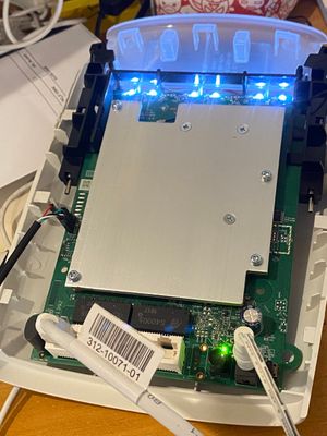

So I've opened the router, found the serial pin on the motherboard and bought a USB-serial cable. Now I can access to the bootloader console but I lack knowledge on this.

BTW, how did you open the RBR outter case?

To open the outter case, you have to remove the sticker at the back, around the ethernet port etc. Then remove the screws that were hidden behind and slide the 2 parts apart (top to bottom). Removing the rubbers at the bottom might help ;)
