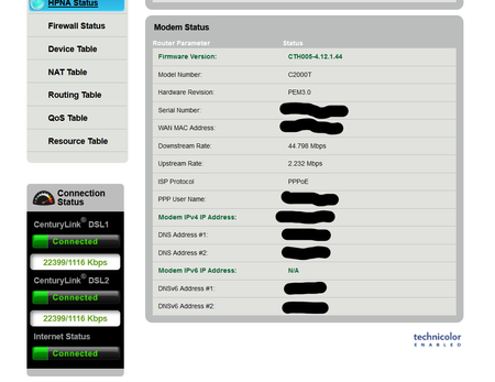

Orbi RBR50 Transparent Bridging not working with Centurylink Technicolor C2000T
I'm trying to get transparent bridging working again. My internet went down and at first I thought it was an issue on my end so I started troubleshooting and for some dumb reason decided it was a goo...
- Aug 16, 2023I got it working.
For anyone running into the same problem, I did two things.
I had centurylink swap out the modem and now I am running on a C4000BG(not a good solution for most but needed to be done in my situation, as michaelkenward mentioned my old router was from 2014 lol)
The second thing I did was instead of selecting “transparent bridging untagged”, I selected “transparent bridging 201”.
Everything is up and running as it was before.
Thanks michaelkenward for assisting.
Hopes this helps anyone else that runs into this issue.

I got it working.
