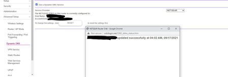

ORBI RBR50 v2 Unable to connect to VPN Windows 10
Hello, I've followed the instructions, read a lot of the discussions here, and watched a youtube video and as far as I can tell I've done everything properly, but when I try to connect it's stuck...
