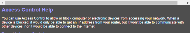

The Help Center says:
Access Control Help
You can use Access Control to allow or block computer or electronic devices from accessing your network. When a device is blocked, it would only be able to get an IP address from your router, but it won't be able to communicate with other devices, nor it would be able to connect to the Internet.
