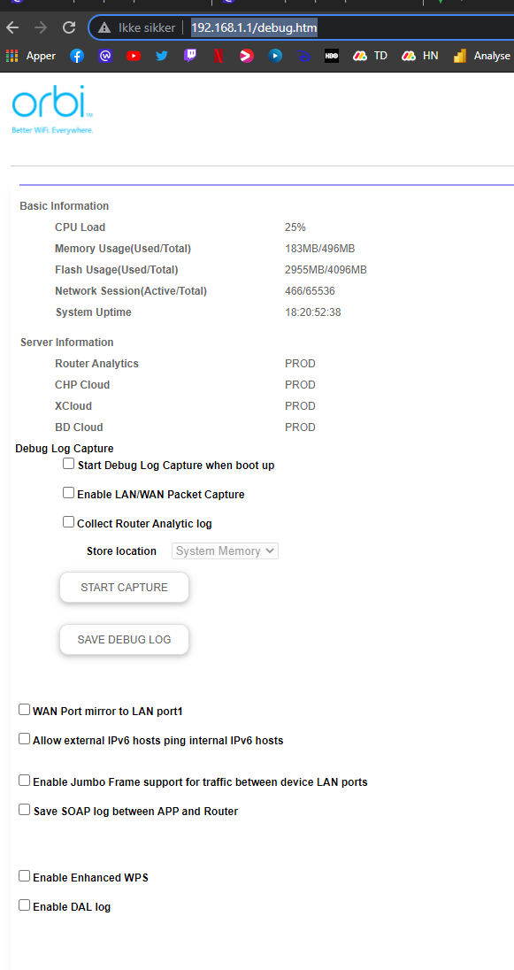

Thanks for the follow-up. Got a similar idea based on your solution that helped me tonight. And I think it's solved.. I hope!
Your input was: downgrade the individual units. Tried that before, since I don't have an old router to set up for a block I did the next best thing and joinked the internet connection with the firmware v2.3.5.30 pre downloaded and ready to be uploaded to the RBR 50 and RBS50 that was stable for me before this update.
When the v2.3.5.30 was installed i turned on the Enable Telnet feature in the 192.168.1.1/debug.htm and turned off the auto upgrade settings in the CMD(telnet).
Fingers crossed that this runs stable now and thanks a lot for all the help and input.
