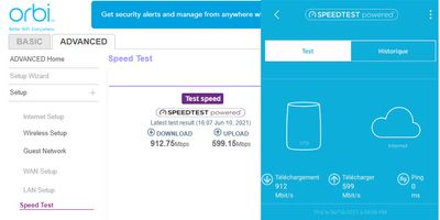

Measured Internet speed indicated by ORBI Software on PC or Android App is 750-850Mb/s
Measured Speed by ORBI
Is it normal to loose HALF of the speed between the devices on a AC3000 devices?
