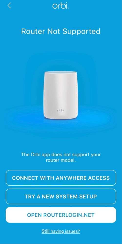

For some miraculous reason, the satellite finally connected after 24 hours of leaving it on. Day later, the other satellite experienced the same problem. UGH!!! Now both are are line. I still have issues trying to connect to the ORBI Router via the Orbi App. Sometimes it works and sometimes it doesn't. "Router not Supported" - "The orbi app doesn't support your router model." But when i connect with "Anywhere access" it works. ALso, when on the ORBI WIFI, after a short time you can't browsae the wen no more, and all my Alexa devices go offline. SOmething weird is happening and i don't know what it is. SHOuld i reboot the entire system and start from scratch and set up as a new system?
From Orbi App.
