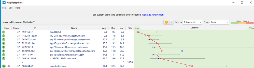

Ping Plotter identifies the latency from the host computer (the PC connected to the Orbi satellite) through each data center through the ISP and internet until it reaches the ultimate destination. Here a test against twitter.com shows that one of the intermediate points appears to have a huge variability:
This example was with a PC connected directly to the RBR50 router, so ping times are very short. It would be interesting to see how much the times to 192.168.1.1 vary on your system.
