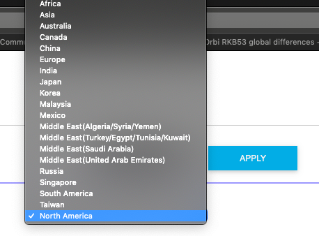

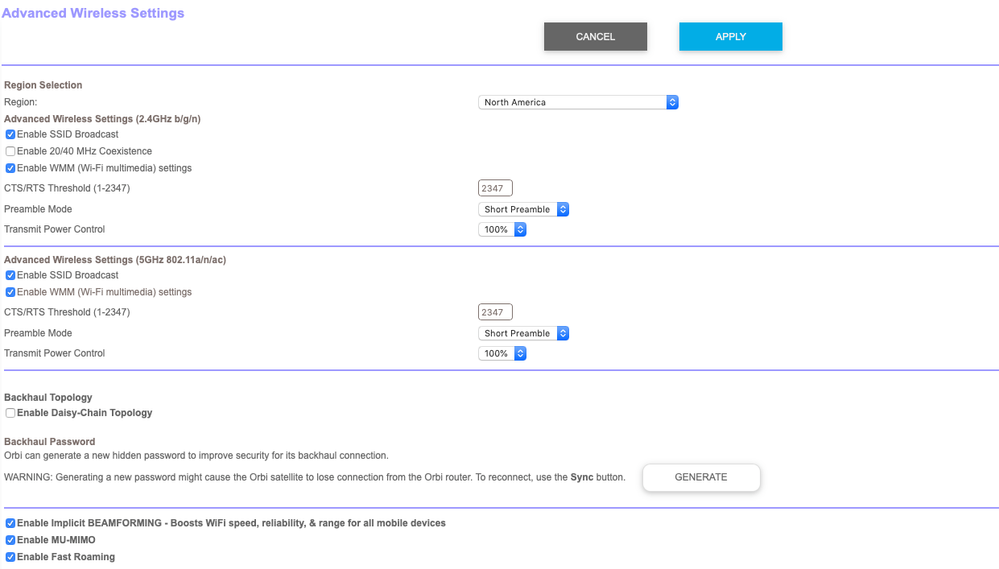

- SW_Apr 11, 2019Prodigy
When you boot/setup Obri router in EU or any other regions, it will figure out the correct region automatically. If not, it can still be changed, but you might be running afoul with local channels.
For example, this shows that it can be changed and all the supported regions.

- MarcusVRSep 24, 2019Tutor
Hi guys!
I live in Brazil and bought a RBK53 set from USA Amazon, now running the firmware
V2.3.5.30. I followed the steps to access other regions, but the range of channels available didn't change - it is locked to the range from 36 to 48 in 5Ghz band - and, after a reboot, the option was locked again. I'd like to use upper channels in 5Ghz. Some tips?Thanks in advance!
