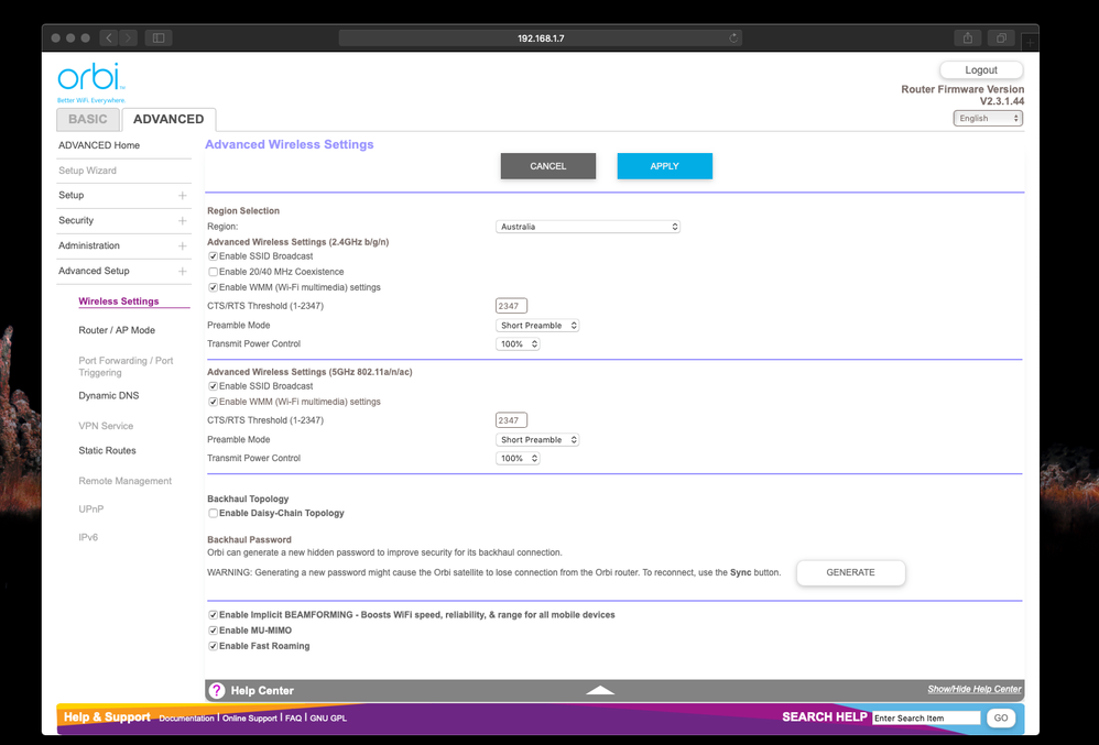

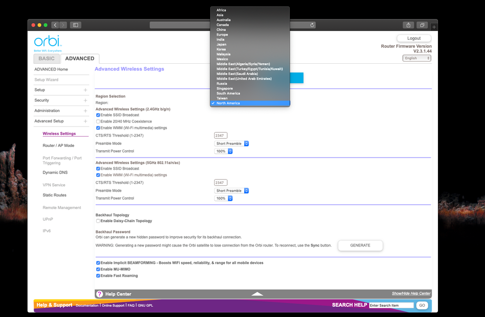

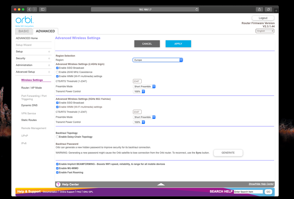

Here are some update pictures to show that region can be changed via Orbi's UI to Europe, Australia, and back to North America.

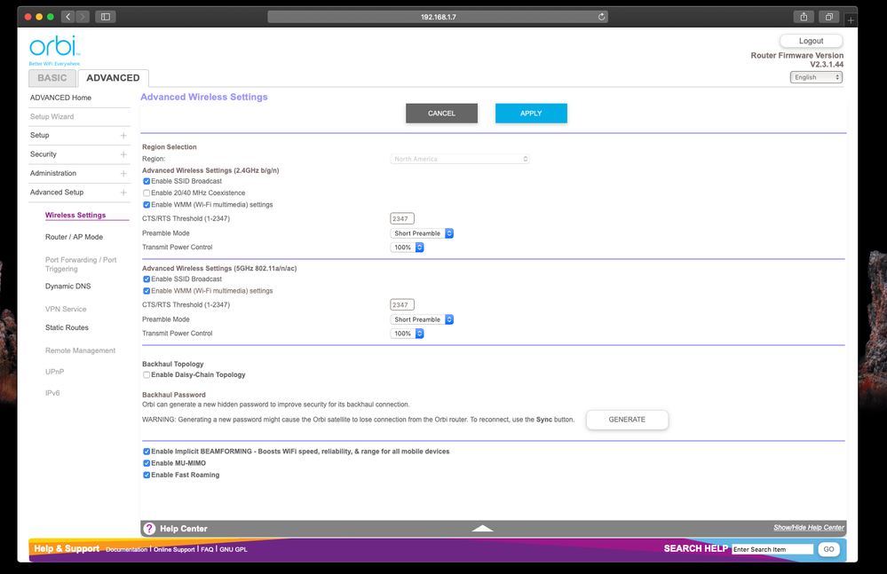

If it helps, here is a screen shot before where it's disabled. The reason I enable it on my Orbi was only to help OP and let him know it's okay to purchase from Costco bring it back home to save some money.
- michaelkenwardApr 14, 2019Guru - Experienced User
