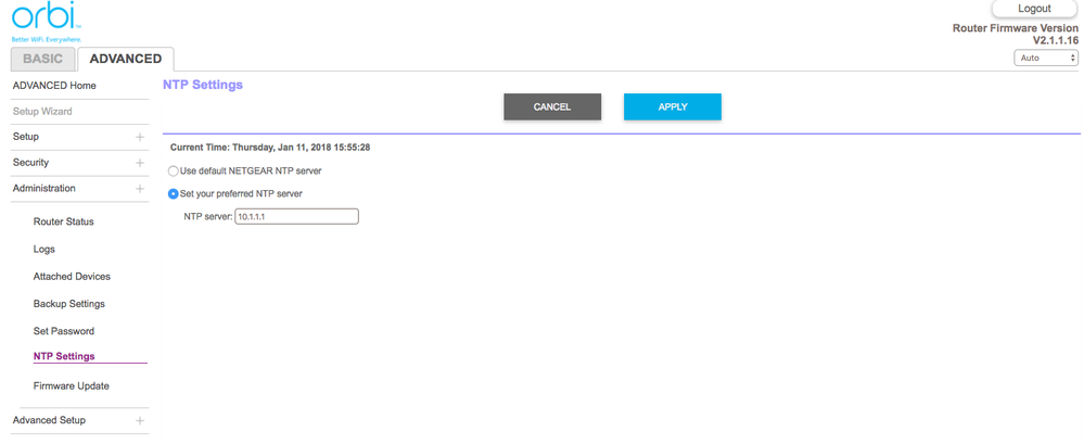

- DalekchapJan 06, 2018Guide
Since I made the change to the NTP server, I have not experienced the solid magenta. I suggest you try that and see if it works for you.
- Pab90Jan 11, 2018AspirantHow do you change the NTP server? Thanks in Advance.
- jacherJan 11, 2018Star
Under Advanced tab, Administration: NTP Settings. I changed mine to my firewall once I got to 2.1.1.16 (which allowed specifying NTP server setting) which also acts as a NTP server. No magenta colours.
