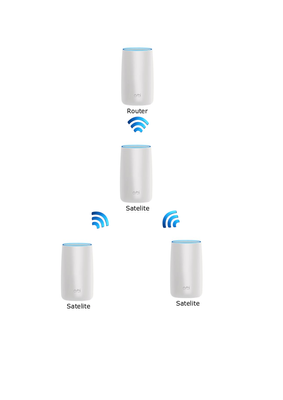

Orbi Satelite Daisy Chain
The new firmware enable daisy chain, satelite to satelite. But will it supports above topology?
