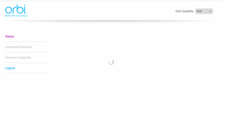

Orbi satelite firmware hanging on installation
Hello, I got the RBK53 mesh system installed. The thow satelites are connected via backhaul ethernet to the router. One of them is working fine, the other one didnt came up correct. Its not showi...

Can you select the FW Upgrade menu item at all?
Press the reset button for 15 seconds then release.
What happens if you disconnect the ethernet cable and sync the RBS wirelessly to the RBR first? Its recommended to first wirelessly sync the RBS and let them come to ready, then ethernet connect them one at a time.
What CAT# cable are you using? CAT6 is recommended.
Try swapping RBS locations with each other to see if the problem follows.

mine is doing the same
