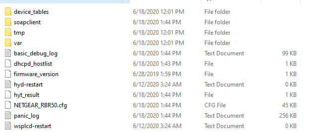

- tubphoojJun 18, 2020Tutor
i have the debug logs. there are a ton of stuff here. any instructions or documentation i can use to decipher this mess?
it has alot of protected data, e.g. encryption codes, mac, ips, ssids, etc... dont think i can share it w the community. its just outside warranty, can i open a ticket w support still?

- CrimpOnJun 18, 2020Guru - Experienced User
tubphooj wrote:i have the debug logs. there are a ton of stuff here. any instructions or documentation i can use to decipher this mess?
Correct, the entire debug log contains lots of sensitive information. Netgear provides "complimentary 90 day support" for new systems, so if the system is less than 90 days old, you can contact Netgear support. After 90 days, customers can purchase support or (as I do) turn to other customers in the community forum for information.
What I want is a tiny portion of the debug log. A tiny part of the file "lan.pcap" that is one of the many files included in the debug zip file. Only the "dhcp" and "dhcpv6" packets. The process I would use to extract these packets is to open the lan.pcap file with Wireshark, create a "Display Filter" to show only these packets, then create an extract file with only those selected packets. To verify that this is the only information being shared, open that new file with Wireshark and it will contain only those packets.
I believe there are restrictions on which file types can be attached to a message, so the process to share "other things" is to put the file on DropBox, Google Drive (or something similar), create a "link" to the file, and then share the URL.
- tubphoojJun 22, 2020Tutor
way above my head now i guess. theres screenshot of the logs i see. no "lan.pcap" file i can see. I downloaded wireshark but no idea what im looking at. is there a youtube tutorial you can share?

- CrimpOnJun 22, 2020Guru - Experienced User
tubphooj wrote:way above my head now i guess. theres screenshot of the logs i see. no "lan.pcap" file i can see. I downloaded wireshark but no idea what im looking at. is there a youtube tutorial you can share?
When I "Save" the debug file, I get a file called "debug-log.zip" in my Download folder (Windows). If I double click on the zip file, it shows LOTS of files. The one of interest is called "lan.pcap" (see attached image). Unfortunately, when people post "inline" images on this forum, the images do not show up until one of the moderators approves them. We can "Browse" and attach files of certain types (attached).
If Wireshark is installed, extract the lan.pcap file and double click on it, which should cause Wireshark to open it.
www.wireshark.org has some tutorials on how to run Wireshark.
