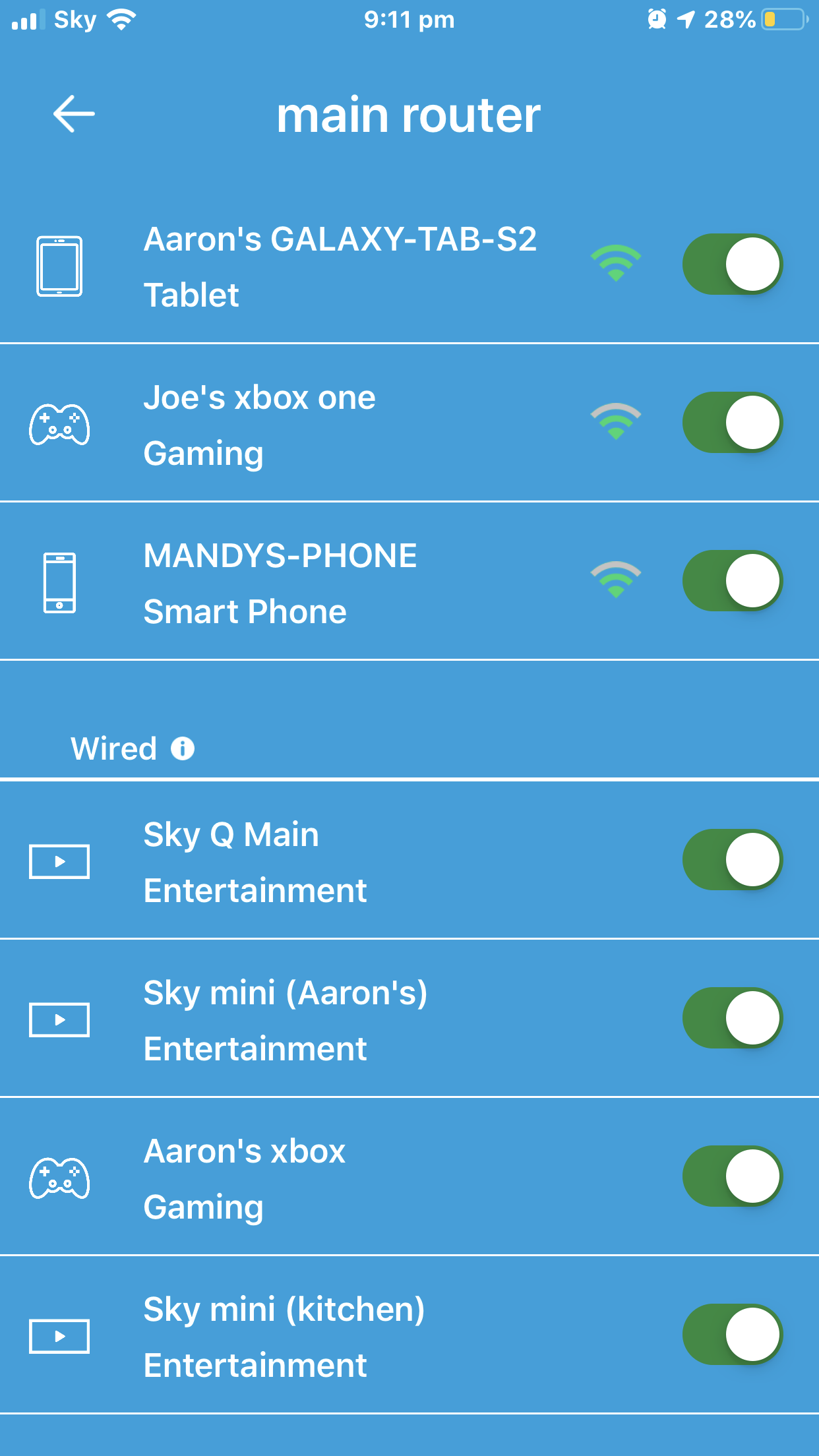

However, now the connection type shows as ‘wired’ (see attached). Why is this? Because the only Ethernet connection from the satellite is to the main Sky Q box???
Any solutions on how to fix the Sky Q connectivity problem/why it shows as wired? 🤔

My orbi satellite shows it’s connection type as ‘wired’ when it should show 2.4/5ghz as the only device which is connected to the satellite via Ethernet is my Sky Q silver box. The sky q box does not show on the connected devices page for the satellite. - CrimpOnGuru - Experienced User

Yeah I think your on the right lines. There’s no way to check the ‘powerline’ setting that I know of, I just know that the main Sky Q communicates with the other sky minis via 2.4ghz and 5ghz... creating another WiFi mesh.
It’s just strange how in the Orbi App , all of my Sky Q products show as ‘wired’ to the main Orbi router... however only the sky q main box is wired to the satellite and a mini is wired to a switch which is wired to the Orbi router!- CrimpOnGuru - Experienced User
Aronius wrote:
It’s just strange how in the Orbi App , all of my Sky Q products show as ‘wired’ to the main Orbi router... however only the sky q main box is wired to the satellite and a mini is wired to a switch which is wired to the Orbi router!In my experience, "wired" means as far as the Orbi router is concerned, it came into the Orbi network "on a wire". I have WiFi cameras that connect to an access point (not Orbi) which is connected to my Orbi using Powerline. The Orbi reports them all as "wired". Only devices that come into one of the Orbi products over WiFi are reported as "WiFi."
