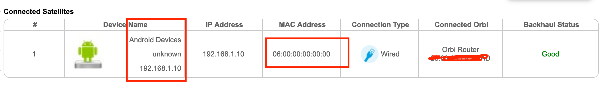

So upon restoring the router's firmware to V2.2.1.210, i rebooted the router. I factory restored the Sallite and tried the sync process again, the syncing process succeeded again, yah... BBUUTTTT.
This time, the router recognises the Satellite and even puts the satllite in the "Connected Satellites" section.. yah.... BBUUTTTT
The router cannot resolve the Satellites "Device Name", it thinks the Satellite is an Android device (wth??), "not to mention the awesome MAC address..
image attached
It looks like the sync process didn't happen properly...?
help? :(
