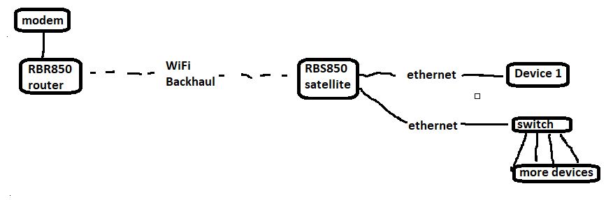

    Later decided that I in fact wanted to hard wire a few devices to the Orbi satellite router to get even better speeds. So I plugged one directly into the satellite via ethernet, and ran a second ethernet cord to another side of the house where it connects to a Netgear unmanaged switch and four devices plug into that.
    Does the attached diagram show the new  configuration?

      Yes, the wired diagram shows the setup, thank you for taking the time to make it!  Update: I have tried unplugging the sonos speakers and confirmed that once they are unplugged the Orbi satellite switches back to 5ghz backhaul and the satellite's wifi and ethernet connection speeds return to normal. I have 3 sonos devices connected, two normal speakers and one "bridge" (whose sole purpose is to boost the sonos wifi connections to other speakers), and I have confirmed that if even one of these devices returns to the satellite's ethernet, the Orbi will go back to "wired" backhaul and connection speeds drop to 4mbps. This is really unfortunate - I feel like a support ticket to netgear is in order because this feels like a bug: the satellite thinks there is a wired backhaul but there isn't one. Any other ideas?
