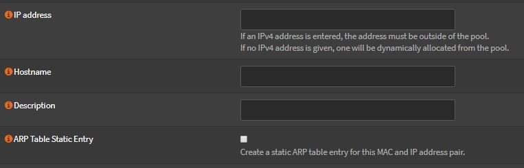

I have my Orbi's set outside of the DHCP range with their IP's reserved for all 3 units. But I have also noticed recently that if I disconnect the wan of my router (not the Orbi) my wifi goes down, which is also odd, as should still be able to access devices on my internal network
The IP address reservation should be from within the Orbi DHCP range NOT outside!
If you get wifi issues when you disconnect the WAN port this tells that your ISP router has also control over routing in your network or is also proving DHCP addressing. Do you have Orbi in Router Mode? If yes is your ISP router bridged? What is the model of your ISP router?

.........I have my Orbi's set outside of the DHCP range with their IP's reserved for all 3 units. But I have also noticed recently that if I disconnect the wan of my router (not the Orbi) my wifi goes down, which is also odd, as should still be able to access devices on my internal network
The IP address reservation should be from within the DHCP range NOT outside!
That depends on router and operating systems, ip reservations can be done outside of the DHCP range
My Orbi is in AP mode and my router (Opnsense) controls the DHCPv4/v6 not the Orbi.
