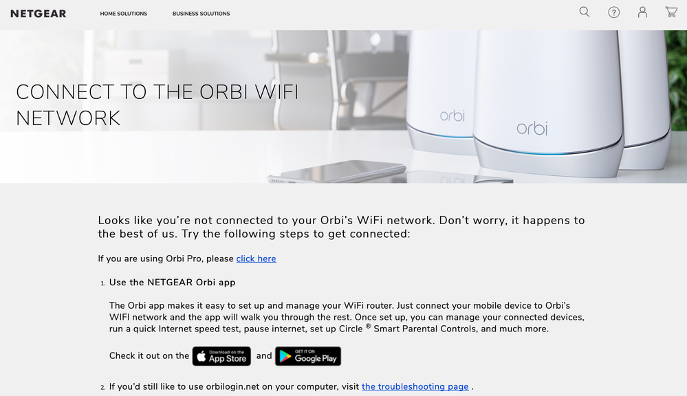

Using the link you proivided, when I click on the orbilogin page, I get a message that I am not connected to my Orbi's WiFi Network, which I clearly am. (See attached.)
This happens when I try to log in at orbilogin.com and orbilogin.net.
Is this a Netgear issue?
