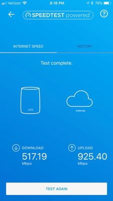

I appreciate the help you are giving me! When I setup the router, I have 3 NEST cameras, a SkyBell HD and 6 WEMO devices to reconfigure with the router. Reconfiguring the NEST cameras means using a ladder up 2 stories to link them to the router using my iPhone camera. That said, I am limited to when I can do thise because of my day job! ;)
I don't understand why two Orbi RBK53 systems experienced the same problem. I might not be able to do anything further until the weekend.
I attached a screenshot from the app after the system was setup and I ran the internet speed test from the Orbi app.
