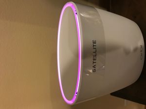

Orbi Solid Magenta appearing on one satellite
One of the satellites is showing this randomly, was working fine for days. Where are the logs located on why it is doing this? I logged into router, but couldn't find the details.

My Netgear Orbi is now running without the solid Magenta light problem, so this problem is really solved with firmware 1.4.0.34.

I was only looking at the Satellite, because that was my problem, and the light of the Satellite did not burn Magenta for several week.
But today I was looking at the Router and I found the light of the Router burning Magenta.
In Netgear Genie I could not find the IP address of the Router, but I found the IP Address of the Satellite and I could ping to the Satellite.
With Wifi Analyzer I saw that both the Router and the Satellite where sending wifi signal and by walking from Router to the Satellite it was switching from signal.
The wifi of both are working, but still the Router is burning Magenta.
So the firmware update solved the Satellite to burning solid Magenta, but did not solve the Router to burning solid Magenta.
