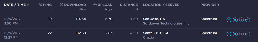

- ThePabloDec 09, 2017Aspirant
So I tried the hardwire vs wifi, using speedtest.net, and very simliar speeds. I will continue using this site or app on my iPhone and no longer use the in-app version of the speedtest as suggested. Thanks for the tips. Posted the details below, the earlier one in the day is wifi and latest via ethernet.
