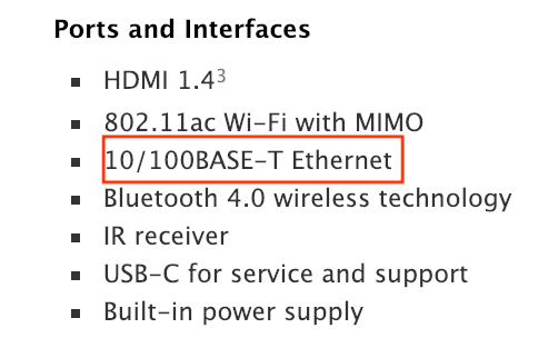

1) Apple TV Gen 4 (https://support.apple.com/kb/SP724?locale=en_US) has 100BASE-T interface so it supports maximum of 100Mbps so you are currently getting good speed from Apple TV:

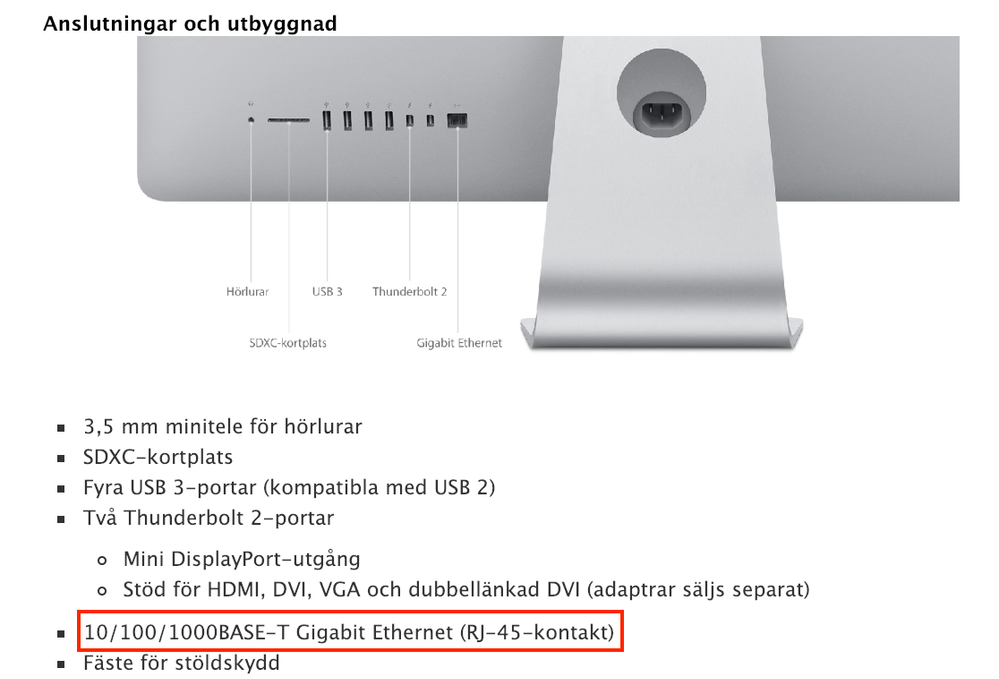

2) iMac (21.5 inch, late 2015): has a 1000BASE‑T Gigabit Ethernet:
So unless you're connecting the iMAC to the RBR40 via a switch with100BASE‑T limitation you should get better speeds. Please confirm that the iMAC is directly connected to the router and not via other network elements.
