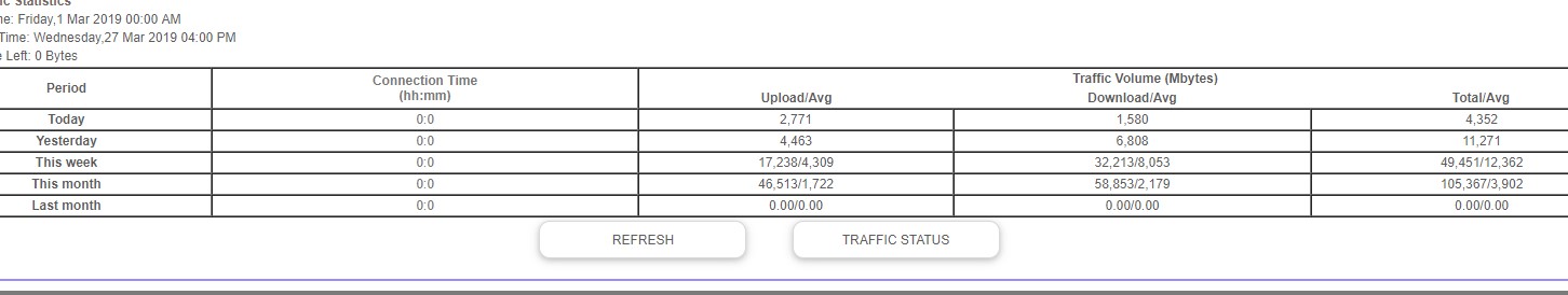

Community Team- Chuck_MMar 27, 2019Mentor
My TM also stopped working after firmware .44 for RBK-50 in router mode.
At least in my case, it doesnt have anything to do with DST... I have tested both settings and neither works.
Look at this screen capture under the connection time and then look at the top of since.
Data is not correct (if there at all). Let me know if you want other testing done. Glad to help.
With about 100 devices -- many of them on reserved IPs, I am hesitant about performing a factory reset.
Chuck
