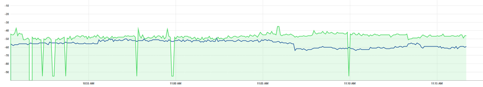

All devices connected to 2.4g drop connection and then reconnect. System has been stable but over the past week very unstable. Upgraded firmware, with no improvement.
Upgraded to beta V2.1.2.10 yesterday, was semi stable during the day, but overnight some devices dropped over 200 times. Wired and 5g devices seem to work fine.
