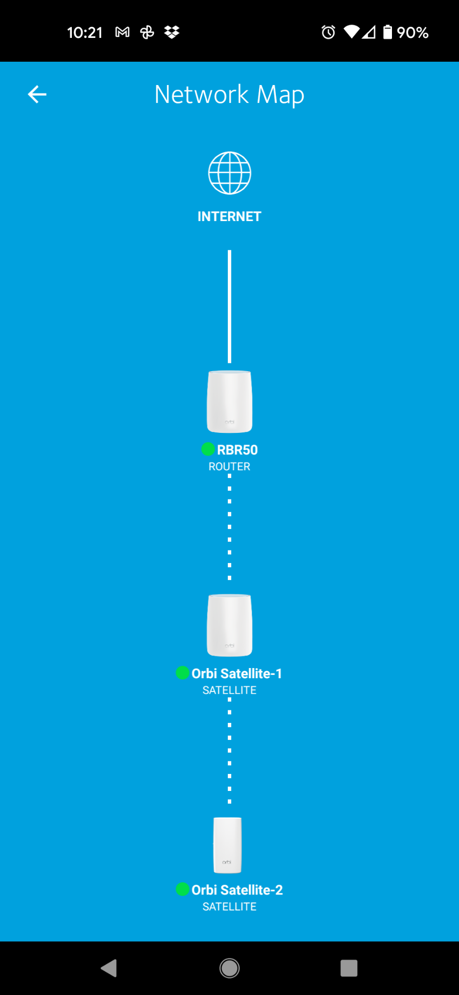

Thanks CrimpOn , that makes a lot of sense. If I stay with the Orbi, the only solution I can think of is to get a second satellite to put on the ground floor where I seem to get a lot of interference (many wifi networks show up from our my house and even my garage door wireless keypad outside sometimes can't connect to the opener inside). But I'll have to use daily chaining to get to get the signal from the second floor's satellite to the one on the first floor as simply moving the only satellite I have to the first floor does not provide a good connection from the base.
Any experience with using daisy chaining? I read on one of those threads that it should be turned off when connecting devices like the Nest. So, I've worried that spending another 200$ might not get a result at the end. Also, is getting a second RBS50 the best option or can I go with the RBW30 (smaller & cheaper) or the RBS50Y in this scenario of a 3rd unit through daisy chain?

I've used the orbi in both daisy chain, star configuration, and with a hardwired backhaul. All worked fairly well. The hardwired backhaul is the best but I did use daisy chain setup to cover my garage and its worked quite well. You don't have to get the RBS50 or RBS50y but it is something to keep in mind that the other versions don't use the 1733mbps backhaul but use the 866mbps. So put them at the end of the chain to prevent bottlenecking in the middle.
I've used nest to with daisy chaining and it was able to sustain a decent connection. I do have over congested 2.4ghz in my area and this causes some issues with my Iot devices that are only on 2.4ghz. I usually dont' recommend using the auto setting for 2.4ghz but its made my 2.4ghz more stable and functional. this isn't always the case so try both auto and manually setting channels.
